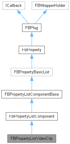

PropertyList: VideoClip More...
#include <fbvideo.h>
Public Member Functions | |
| FBVideoClip * | operator[] (int pIndex) |
| Get the video at pIndex. | |
