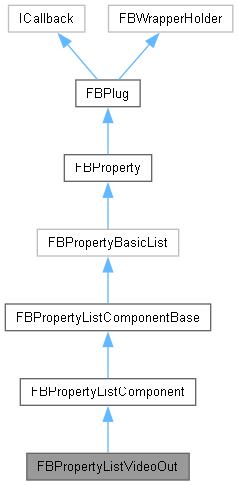

PropertyList: VideoOut More...
#include <fbvideo.h>
Public Member Functions | |
| FBVideoOut * | operator[] (int pIndex) |
| Get the video at pIndex. | |

Protected Attributes inherited from FBPropertyListComponentBase | |
| int | mClassId |
| Class Id. | |
| bool | mParents |
| mParent. | |
Protected Attributes inherited from FBProperty | |
| FBString | mName |
| void * | mParent |
Protected Attributes inherited from FBPlug | |
| bool | mAllocated |
| Contain the Allocation State of the Component. | |
| HIObject | mObject |
| Handle on the Plug. | |
| bool | mSDKComponent |
| bool Plug is an SDK component. | |
