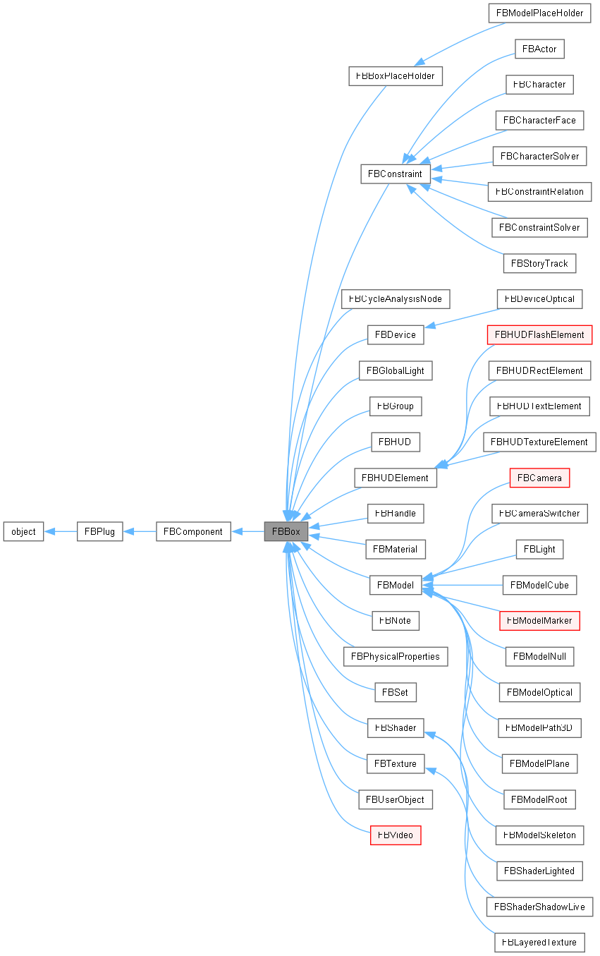

| | FBBox (str pName) |
| | Constructor.
| bool | AnimationNodeDestroy (FBAnimationNode pAnimationNode) |
| | Destroy an animation node.
| FBAnimationNode | AnimationNodeInGet () |
| | Get the (IN/OUT) animation node for this box.
| bool | AnimationNodeIsUserData (FBAnimationNode pAnimationNode) |
| | Is the animation node user data?
| FBAnimationNode | AnimationNodeOutGet () |
| str | FbxGetObjectSubType () |
| | Returns the class sub type inherited by the class of an object, for example: 'Relations', 'Parent-Child', 'Number to Vector', 'Shot'.
| str | FbxGetObjectType () |
| | Returns the class type inherited by the class of an object, for example: 'Box', 'Constraint', 'TimelineXTrack'.
| FBAnimationNode | GetInConnector (int pIndex) |
| | Get the animation node input associated with the given index.
| int | GetInConnectorCount () |
| | Get the number of animation node inputs for this box.
| FBAnimationNode | GetOutConnector (int pIndex) |
| | Get the animation node output associated with the given index.
| int | GetOutConnectorCount () |
| | Get the number of animation node outputs for this box.
