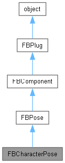

Used to work with character poses. More...
#include <pyfbsdk_generated.h>

Public Member Functions inherited from FBPose | |

Public Member Functions inherited from FBComponent | |
This class exposes the object used to store the pose of objects.
