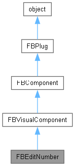

Number edit box. More...
#include <pyfbsdk_generated.h>

Number edit box.
| FBEditNumber | ( | ) |
Constructor.
