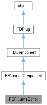

| | FBFCurveEditor () |
| | Constructor.
| | AddAnimationNode (FBAnimationNode pNode) |
| | Add an animation node to the editor.
| | AddProperty (FBAnimatable pProperty) |
| | Add an animatable property to the editor.
| | Clear () |
| | Clear the editor.
| | RemoveAnimationNode (FBAnimationNode pNode) |
| | Remove an animation node from the editor.
