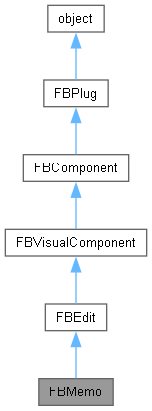

| | FBMemo () |
| | Constructor.
| | GetStrings (FBStringList pLines) |
| | Get the content of the memo.
| | SetStrings (FBStringList pLines) |
| | Set the content of the memo.
| | FBEdit () |
| | Constructor.
| | FBVisualComponent () |
| | Constructor.
