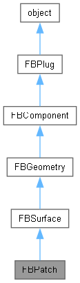

Patch class. More...
#include <pyfbsdk_generated.h>
Public Member Functions | |
| FBPatch (str pName) | |
| Constructor. | |
| ControlPointsBegin () | |
| Begin control points edition. | |
| ControlPointsEnd () | |
| End control points edition. | |
| SurfaceBegin () | |
| Begin Patch definition. | |
| SurfaceEditBegin () | |
| Begin patch surface edit. | |
| SurfaceEditEnd () | |
| End patch surface edit. | |
| SurfaceEnd () | |
| End Patch definition. | |

Patch class.
| ControlPointsBegin | ( | ) |
| ControlPointsEnd | ( | ) |
| SurfaceBegin | ( | ) |
| SurfaceEditBegin | ( | ) |
| SurfaceEditEnd | ( | ) |
| SurfaceEnd | ( | ) |
| FBSurfaceType USurfaceType |
Read Write Property: Patch mode for U direction.
| FBSurfaceType VSurfaceType |
Read Write Property: Patch mode for V direction.
