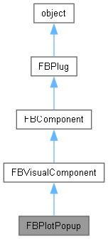

Plot Popup (for setting options only). More...
#include <pyfbsdk_generated.h>
Public Member Functions | |
| FBPlotPopup () | |
| Constructor. | |
| FBPlotOptions | GetPlotOptions () |
| Get plot options. | |
| bool | Popup (str pWindowName) |
| Execute plot popup. | |
| SetPlotOptions (FBPlotOptions pPlotOptions) | |
| Set plot options. | |
