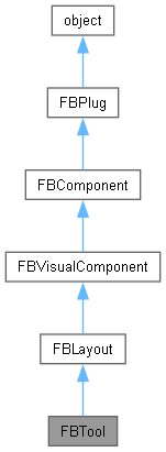

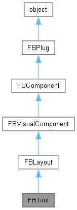

Tool class. More...
#include <pyfbsdk_generated.h>
Public Member Functions | |
| FBTool (str pName=None) | |
| Constructor. | |
| FBTool (str pName, bool pRegisterTool) | |
| Constructor used when creating tools not in the Tools menu of MotionBuilder. | |
| FBToolPossibleDockPosition | GetPossibleDockPosition () |
| Get the possible docking position for the tool (concatenated). | |
| SetPossibleDockPosition (FBToolPossibleDockPosition pFlags) | |
| Set the possible docking position for the tool. | |
Public Member Functions inherited from FBLayout | |

Tool class.
See samples: MBFileRefDemo.py, CloseTool.py, MoveResizeToolExample.py, SafeToolCreationExample.py, ToolCommunicationReceiver.py, ToolNativeWidgetHolder.py.
