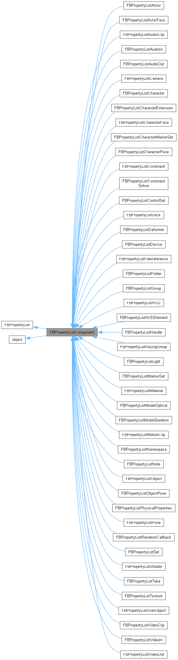

Inheritance diagram for FBPropertyListComponent:
