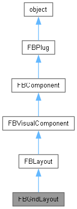

More advance layout that allow organisation of control in a grid. More...
#include <pyfbsdk_additions.h>
User can place a control at specific coordinates. User can also setup parameters that affect whole row or column.
| FBGridLayout | ( | spacing | ) |
