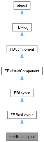

This class manages a FBBoxLayout Horizontal (see FBBoxLayout for documentation on how to Add/Remove control). More...
Add method specify the fixed width of a control.
| FBHBoxLayout | ( | floworientation | ) |
floworientation: FBAttachType.kFBAttachLeft : all controls added from left to right -> FBAttachType.kFBAttachRight: all controls added from right to left <-
