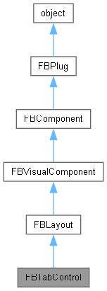

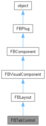

A real FBTabControl that improve the behavior of the FBTabPanel. More...
#include <pyfbsdk_additions.h>
This class manage the Tabs and the 'middle region' used to display. It manages all the region 'swapping' necessary to implement a Tab behavior. - Use Add method to Add a Control to the FBTabControl. This will create a tab and ensure that when that tab is clicked the Control is shown. - Use SetContent with a tab index To specify which tab should be displayed.
