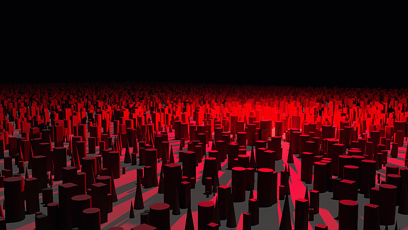

USD for Maya 0.31 now supports light linking.
Light linking support
USD for Maya 0.31 now supports light linking, giving you more control over the relationships between lights and objects in your scene.
