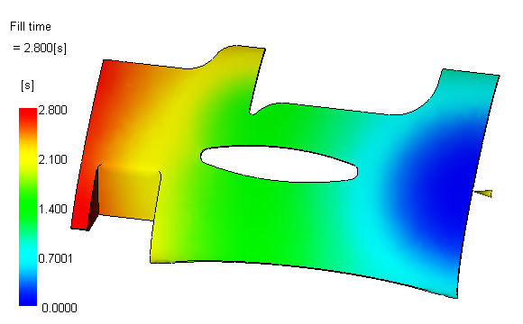

In this tutorial, you simulate the filling phase in a part. The feed system is not included. The filling phase is the most important phase of the injection molding cycle. If there are problems with the filling of a part, the part quality is not optimal.
