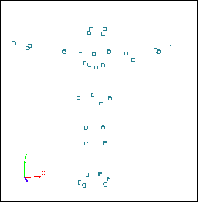

  1. Load a file containing optical motion data.
    Motion capture data loaded in the scene
    Ideally, the markers load in a T-stance facing the positive Z-axis. When capturing motion data, you should always start or end your take with the performer in a T-stance facing the positive Z-axis.
