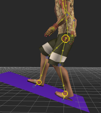

  4. Translate and rotate the floor object(s) to represent the type of terrain you want to your character’s feet and hands to respect.
    For example, if you want the character to walk on a sloped floor as shown in the following figure, rotate the floor object to represent the angle you want the character to walk on.
