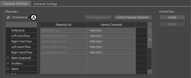

  2. In the Navigator window > Character Settings > Character Definition pane, activate the Characterize option.
Character Definition pane A. Characterize option

Activating the Characterize option updates and lock the character definition in the Character Controls window > Definition tab.
  1. A dialog box appears to remind you that your model must be in a stance facing the positive Z-axis. Choose between two types of postures for your character (Biped or Quadruped).
