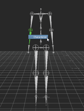

To characterize a 3ds Max biped:
  1. Choose File > Open.
  2. On the Open File dialog box, locate the 3ds Max Biped and click Open. Leave the default settings unchanged in the Open Options dialog, and click Open.
  3. From the Asset browser, click the 3ds Max Biped Template asset and drag it onto the 3ds Max Biped.
Drag the 3ds Max Template onto the Biped in the Viewer window.
  1. Click Characterize.
Your 3ds Max Biped is fully rigged.
