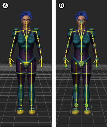

To hide Control rig effectors:
  1. Select the effectors in the Character using the Character representation in the Character Controls window, the Viewer window, or Schematic view.
  2. From the Resources window > Properties tab > Select Property View drop-down list, select All (Type).
  3. From the Marker Settings > Look drop-down list select None.
    Control rig effectors A. None option selectedB. Sphere option selected

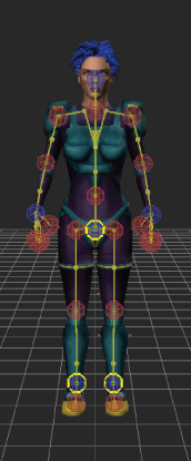

To change the size of IK or FK effectors:
    Note:
    Turn on or off all IK or FK effectors on a Control rig from > Show/Hide menu. (For a clearer view, you can also deactivate options to isolate your selection on the rig.)
  3. Change the size of the effectors using the Marker Settings > Size field.
    IK effectors set to 400.00
