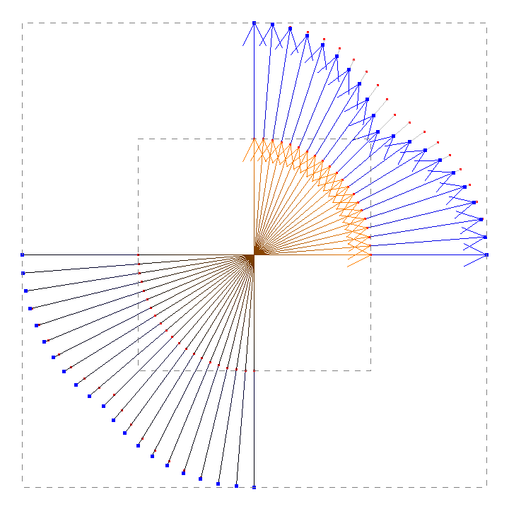

Parameter Simple Stripe Quad Checker Radial
Hatch distance
Distance between hatchlines
Yes Yes Yes Yes Yes; target median distance
Radial center
Choose between drawing radials per island (if there are multiple in a slice) or for the entire occupied area of the current slice (not the complete slice stack). In any case, the radials are drawn around the geometric center of the respective area or areas.
Yes
Mode
Switches between radial and spiral hatching (separate concentric stripe rings vs. single spiralling stripe)
Yes
Spiral direction
Choose between Clockwise and Anti-clockwise.
Yes
