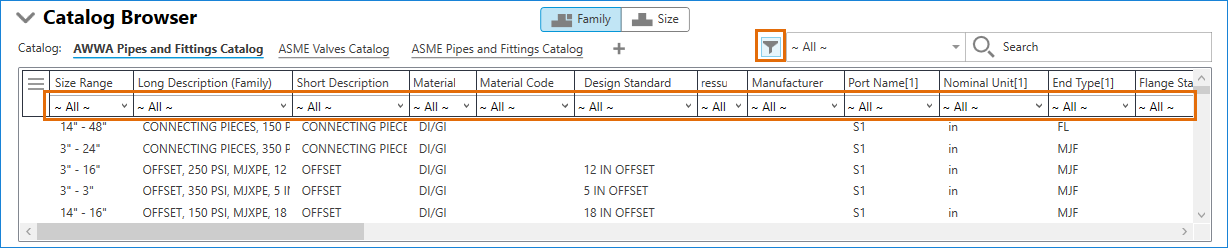

- On the Catalog Browser, click the button on the left side of the search bar to enable the property filter.
- In the Short Description dropdown list, select CAP.
- In the Material dropdown list, select DI/GI.
- Specify a size range (for example, 3” to 12”).
- Click Add to Spec.
