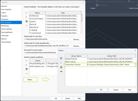

Twinmotion version selection
When you have more versions of Twinmotion installed, Open in Twinmotion launches the most recent version. If you want to use a different version, set a new variable, for example Twinmotion Version, in Options File Locations Places, and add the Library Path for this variable corresponding to the desired version of Twinmotion:
