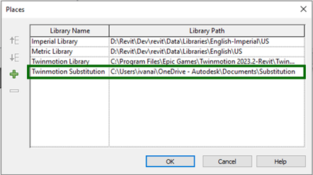

Starting with Revit 2026, you can edit the dynamic substitution path for storing the downloaded assets:
Options
 File Locations
 Twinmotion Substitution entry.
