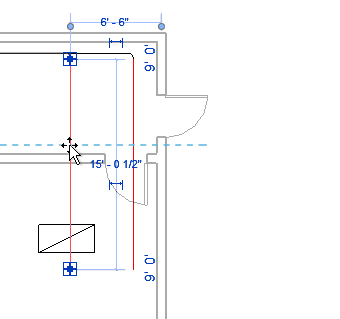

Select a conduit segment or run and do one or more of the following:
- On the Modify | Conduits tab, specify a command.
- On the Options Bar, specify conduit options.

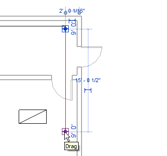

- Drag the control to move or extend the conduit segment to a new endpoint or to connect with another conduit.
- Drag the conduit segment to a new location.
