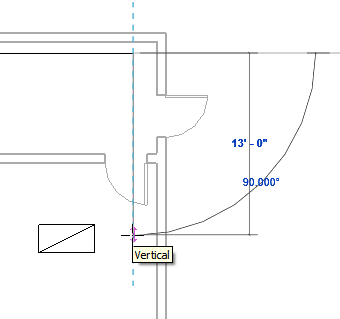

- In the drawing area, click to specify the start of the conduit run, then move the cursor and click to specify points along the run.
A bend is automatically added to the segment where needed.
 When you draw conduit with fittings, connection lines for the fittings are displayed.
- To draw vertical conduit, specify the start of the conduit run, then on the Options Bar, specify the offset value, and continue drawing the conduit run.
Rise symbols and drop symbols are inserted as needed.
