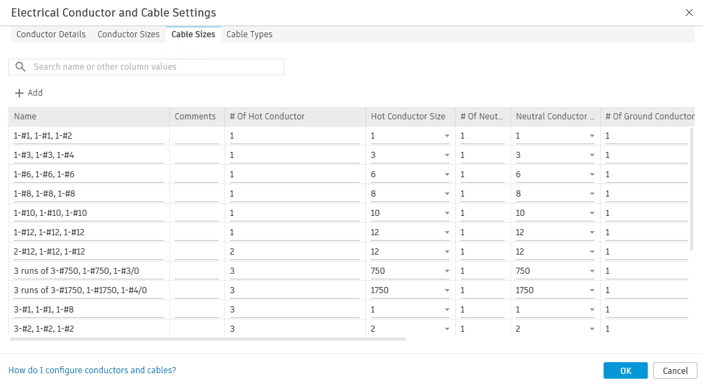

Use this dialog to specify wiring and cable parameters. Use the defined conductors in circuits in your model's electrical designs.
Define key conductor characteristics, including conductor material, size, and insulation material. Then, utilize those conductors in various cables and cable types. Assign appropriate cable types for use in your circuit designs.
To open electrical conductor and cable settings, click Manage tab
Settings panel
MEP Settings drop-down
 Electrical Conductor and Cable Settings.
