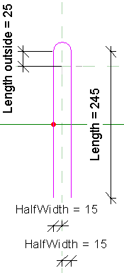

Learn how to model a single loop connector family for solid walls.
The single loop connector family can be used in multiple loop families. This example is a metric family, but you can create Imperial versions similarly.

   Sweep path
 Sweep path

   Sweep path
 Sweep path

   Draw path

  The loop connector family is ready to save and load into your multiple loop connector families.
