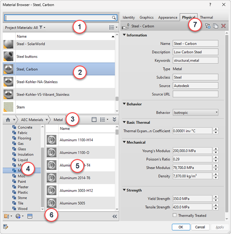

 To work with libraries, access the Material Browser by clicking Manage tab
Settings panel
 (Materials).
| Region | Function |
| 1 |  Project materials filter
			  : Filter project materials by class. Show/Hide project materials settings menu
			  : This button lets you modify the view of project materials and the library panel in the Material Browser window. Use the project materials settings menu
			   options to filter the display of materials presented in the project materials list.
| 2 | Project materials list: Displays materials in the current project, whether they are applied to objects or not. Select materials from the list and then Right-click to access a menu of common tasks such as Rename, Duplicate, and Add to a Library. |
| 3 |
			  Material Libraries toolbar: Provides controls to manage libraries, create new or duplicate existing materials, or open and close the Asset Browser. Show/Hide Library Tree
| 4 | Library list: Displays open libraries and categories (classes) within libraries. |
| 5 | Library materials list: Displays materials in the library or category (class) selected in the library list. |
| 6 | Material Browser Toolbar: Provides controls to manage libraries, create new or duplicate existing materials, or open and close the Asset Browser. |
| 7 | When a material is selected in the library list (left pane), this right pane displays the tabs (assets) associated with this material. Click the tabs (for example, Identity or Appearance) to view the properties and assets of the material. When viewing materials in libraries, properties are read-only. |

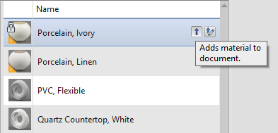

To add a material to the current project, first find the material in an existing library, then use one of these methods:
Add to
Document Materials.
 located to the right of the material.
To copy a material to a library, use one of these methods:
Add to
<Library Name>.
	 If you copy a material to a library where another material of the same name exists, you are prompted either to overwrite the version in the target location, or to keep both. If you keep both, the material name of the material you are copying is appended with a number; for example, Porcelain, Ivory(2).
