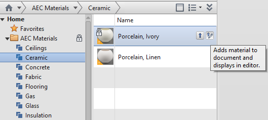

-  Select the material in one of the following places in the Material Browser:
- In the project materials list, click a material.
- In the library materials list, click a material, and then click the Add-Edit
 button. This button adds the material from the library to the project materials list.
	 The Material Editor panel displays the assets of the selected material in edit mode.
