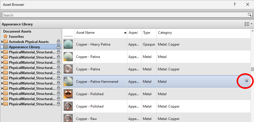

- In the Asset Browser dialog, select the asset to add to the material.
Tip: To locate an asset, use the search bar, or click one of the column heads to sort by name, aspect, type, or category.
- Click the Replace button
located to the right of the selected asset.
Note: When you click Replace, the Asset Browser does not reflect any changes.
- Close the Asset Browser.
The selected asset replaces the original asset in the material and displays in the Material Editor panel.
