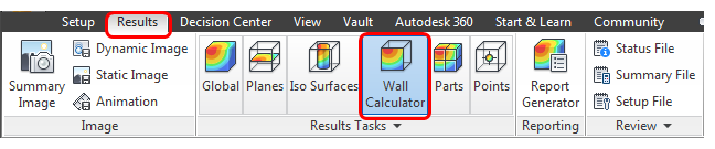

Click Wall Calculator from the Results tab:
