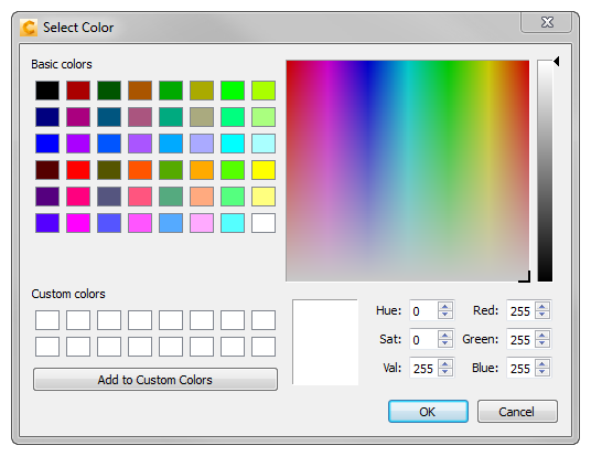

Controlling part appearance is very important when viewing results. Autodesk® CFD provides tools to control how parts appear to allow you to create images and views that best convey the behavior of the design. These commands are available by right-clicking on the model while visualizing Results or by right clicking on the part names in the Results > Material branch of the Design Study bar.
Textures are surface images that can be assigned to parts. They are different from simple colors in that they change the appearance of a part to look like a real-world object or substance. They are a great way to give your model a real world appearance, making for a visually provocative results images.
