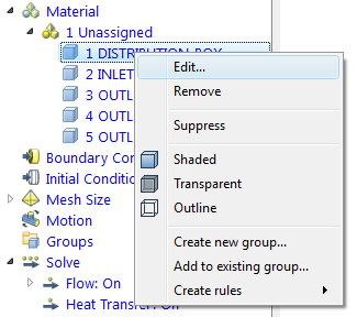

Left click on the part, and click the Edit icon on the context toolbar.
Right click on the part, and click Edit.
Right click on the part name under the Materials branch of the Design Study bar, and click Edit.

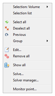

Click Edit in the Materials context panel.

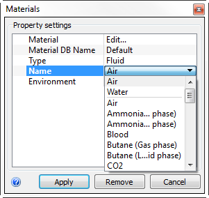

Select one or more parts.
Select the database from the Material DB Name menu.
Select the type from the Type menu.
Select the material from the Name menu.
Click Apply.

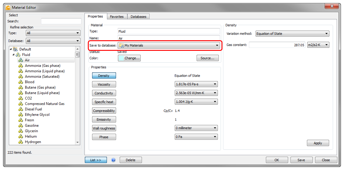

The Default material database contains at least one instance of every material type. A convenient way to create a new material is to use a Default material as an example. Because these materials are read-only, use the Material Editor to copy the original into a custom database, and modify the copy.
To open the Material Editor, click Edit... on the Material line of the quick edit dialog. (Alternatively, click Material Editor from the Materials context panel.)
Click the List button.
Find the material in the list, and left click on it.
On the Properties tab, select a database from the Save to database menu.
Modify the properties as needed, and optionally, specify a new name.
Optionally, click Save.
Click OK. The quick edit dialog displays the material.
