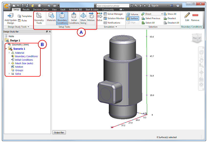

To begin, enable the Boundary Condition task from either the Setup (tab) > Setup Tasks (panel) (A) or from the Design Study bar (B):

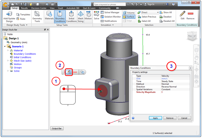

To work close to the model
- Left click on the model entity (surface or part).
- Click the Edit button on the context toolbar.
- Specify settings in the Boundary Conditions quick edit dialog.
Alternatively, right click on the model entity or branch on the Design Study bar, and click Edit...

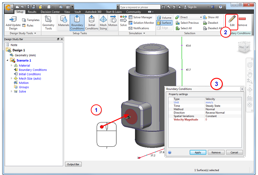

To work away from the model
- Left click on the model entity (surface or part) to select it.
- Click Edit in the Boundary Conditions context panel.

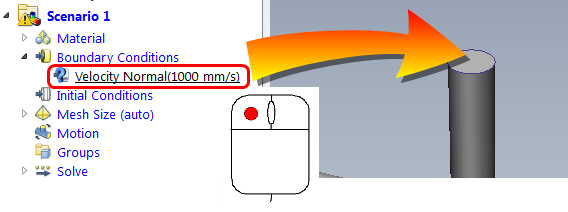

To define and then apply a boundary condition
An alternative workflow is to create a boundary condition before applying it to the model.
- Click Edit on the Boundary Conditions context panel. Alternatively, right click on the Boundary Conditions branch of the Design Study bar, and click New BC....
- Define the boundary condition in the Boundary Conditions quick edit dialog, and click Apply.
- Drag the unassigned setting from the Design Study bar onto the model entity:
Note: To assign a setting that is currently assigned to another object, drag it from the Design Study bar onto the model entity.
