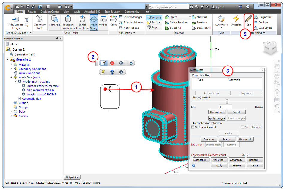

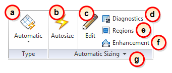

Automatic Sizing:
There are several ways to apply Automatic Sizing:
In the context panel, verify that the Type is set to Automatic. Click Autosize.
Left click on or near the model, and click the Automatic icon on the context toolbar:
Right click in the Graphics window or on the Mesh Size branch of the Design Study bar, and click Edit.... Click Automatic size on the Mesh Sizes quick edit dialog.
Mesh Tools:
Use the Mesh Tools to customize the mesh distribution. All tools are accessible from the Mesh Sizes quick edit dialog. To simplify the workflow, many are also available on the context tool bar and on the context panel.
Context tool bar:
Left click on or near the model:
Context panel in the Ribbon:
On-model mesh modification:

Select the part.
Open the Mesh Sizes quick edit dialog.
Make the appropriate refinements or invoke Automatic Refinement.
