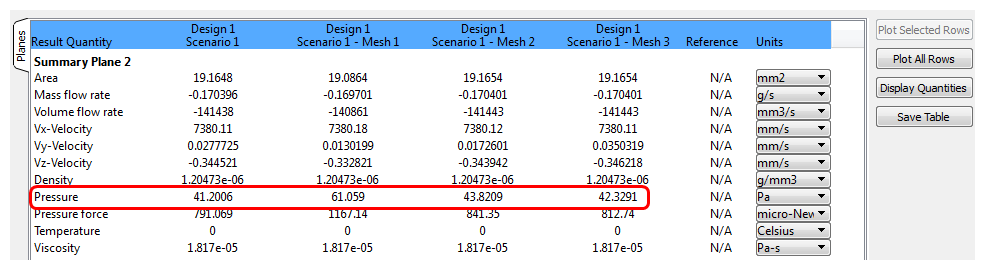

In this step, we use the Critical Values component of the Decision Center to compare outlet flow rates from the two designs.

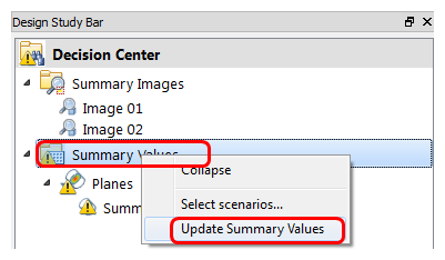

In the Decision Center, right click on Summary Values, and click Update summary values.

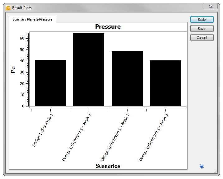

To plot the pressure from the four meshes, click on Pressure, and click the Plot Selected Rows button:
