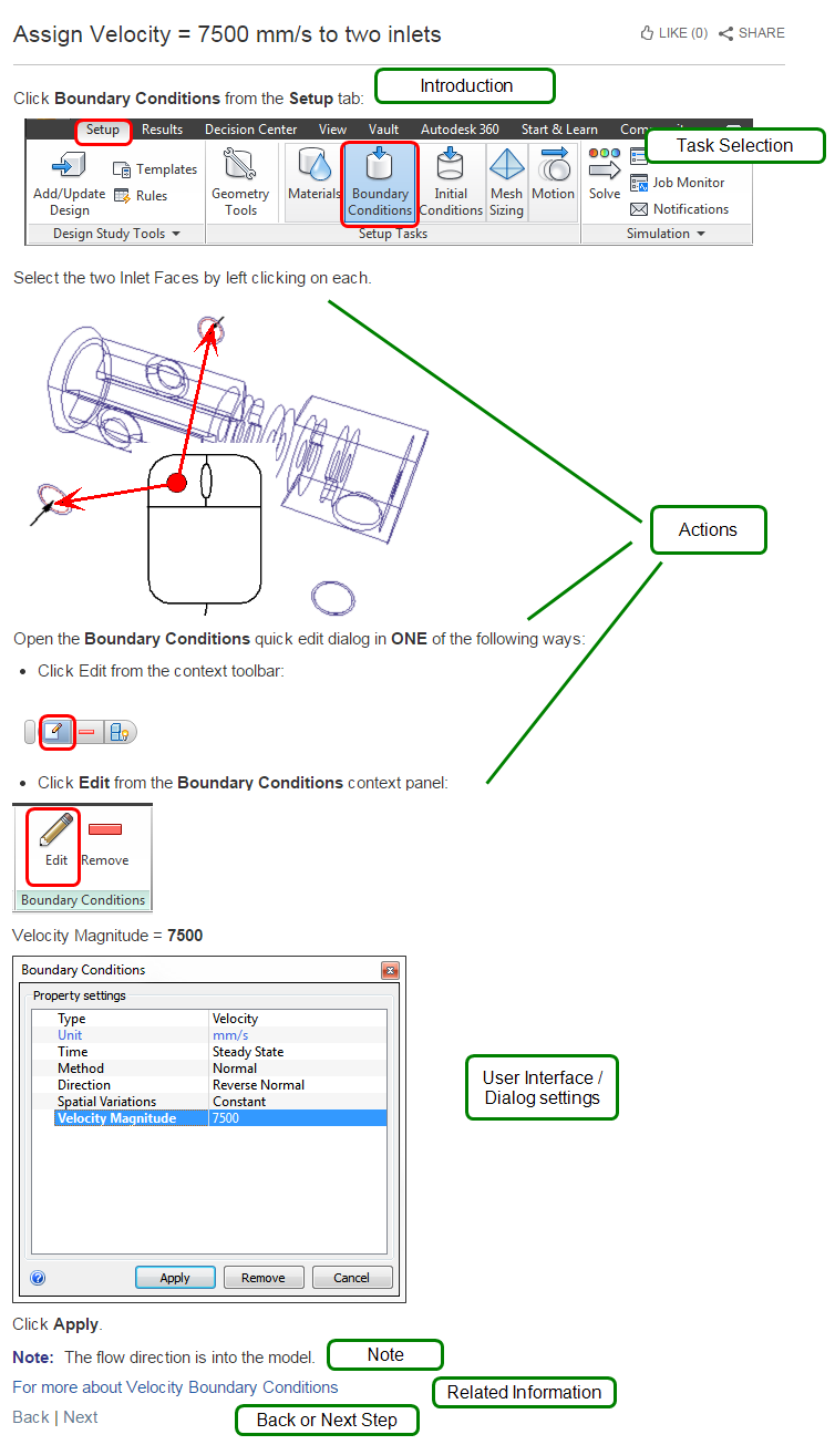

Each tutorial is divided into multiple steps, and each step is presented in its own topic. All steps share a similar format, as shown in this example:
- The introduction often (but not always) describes the purpose of the step. It may also contain an action to change the task.
- When an action involves a mouse click on the model, the appropriate mouse button and model location are shown.
- In many steps, the completed User Interface dialog is shown to summarize the actions.
- Additional information is often given in a Note.
- When appropriate, a link to related information is included in the step. Use this to learn more about the subject-matter in the step.
- When finished with the step, move to the next step by clicking the Next link in the lower left corner.
