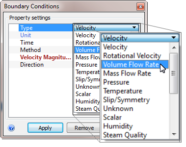

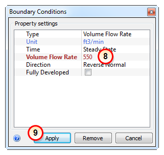

6. On the Type row, select Volume Flow Rate.

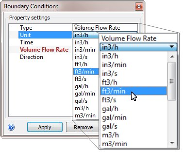

7. On the Unit row, select ft3/min
8. On the Volume Flow Rate row, enter 550.
9. Click Apply.

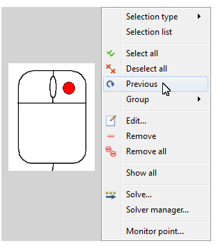

10. Right click anywhere off the model, and select, Previous.

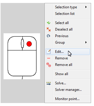

11. Right click anywhere near the model, and select Edit...

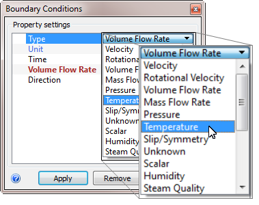

12. On the Type row, select Temperature.

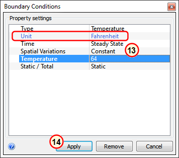

13. Verify the Units are Fahrenheit. On the Temperature row, enter 64.
14. Click Apply.

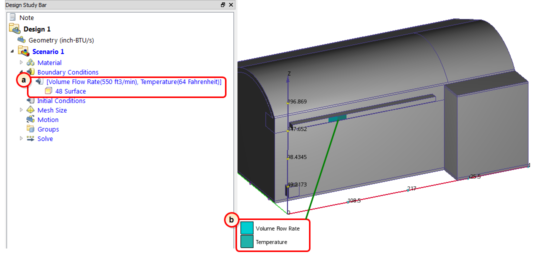

15. To verify that the two boundary conditions are properly assigned to the supply, check the Design Study Bar and the colored stripes on the supply surface:
