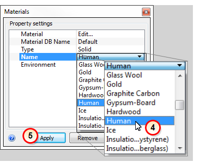

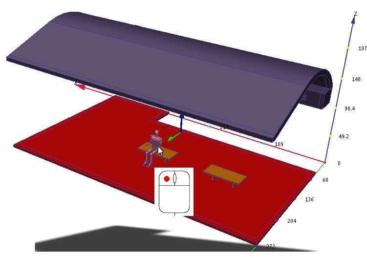

1. Select the occupant by left clicking on him.
2. Click Edit from the Materials context panel:
3. On the Materials quick edit dialog, select the material type:
4. From the Name menu, select Human
5. Click Apply.
What it should look like...

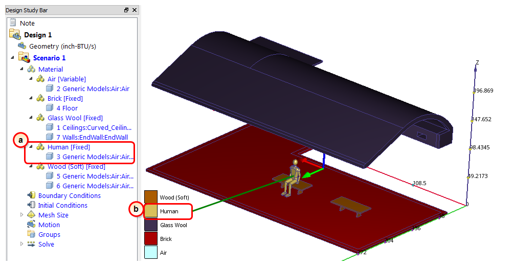

6. To verify that the Silicon material is properly assigned, check the Design Study Bar and the part coloring:
