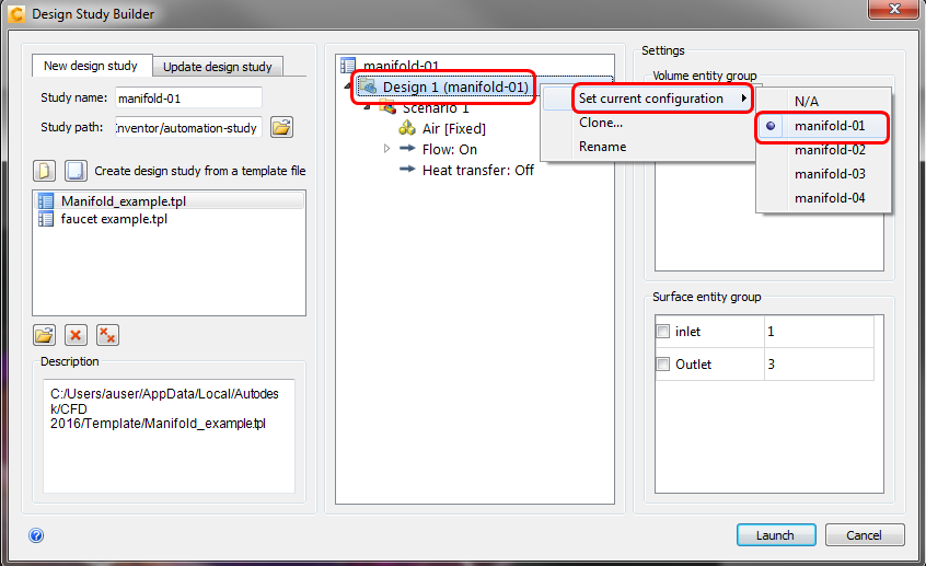

In this step, we will clone the initial design three times to create a design study consisting of four designs. We will then associate each design with a design from the CAD.
Right-click on Design 1.
Click Set current configuration, and verify that manifold-01 is selected from the list.
Right click on Design 1, and select Clone...

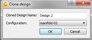

Enter Design 2 for the design name, and select manifold-02 for the Configuration
Click OK.

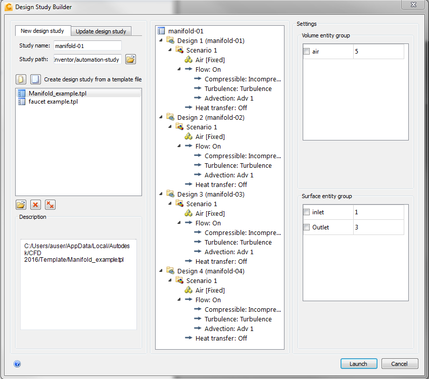

Enter Design 3 for the design name, and select manifold-03 for the Configuration.
Click OK.
Enter Design 4 for the design name, and select manifold-04 for the Configuration
Click OK.
Click Launch to create the design study within Autodesk® CFD.
