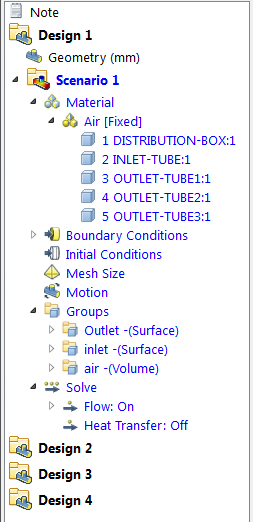

The design study has been created in Autodesk® CFD, and consists of four designs. Each design has a scenario that is fully defined with boundary conditions and materials:

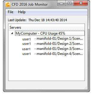

To view the status of each scenario, click Job Monitor from Setup (tab) > Simulation (panel):
For more about the Solution Monitor...
