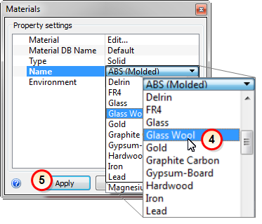

2. Click Edit from the Materials context panel:
3. On the Materials quick edit dialog, select the material type:
4. From the Name menu, select Glass Wool
5. Click Apply.

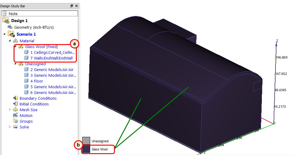

What it should look like...
6. To verify that the Glass Wool material is properly assigned, check the Design Study Bar and the part coloring:
