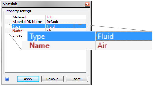

4. On the Materials quick edit dialog, verify the Type is Fluid, and the Name is Air.

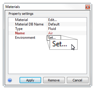

5. In the Environment row, click Set...

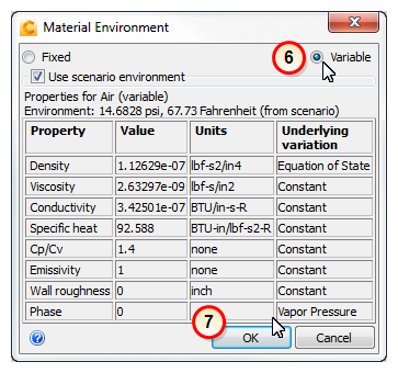

6. On the Material Environment dialog, click Variable
7. Click OK.

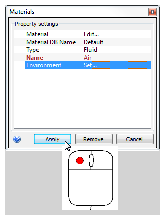

8. Click Apply on the Materials quick edit dialog.
What it should look like...

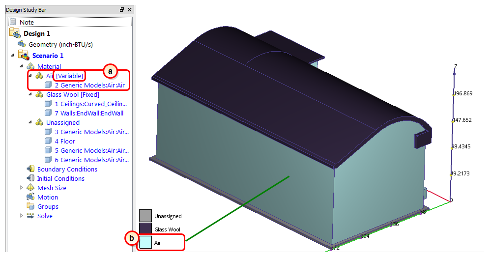

9. To verify that the air material is properly assigned, check the Design Study Bar and the part coloring:
