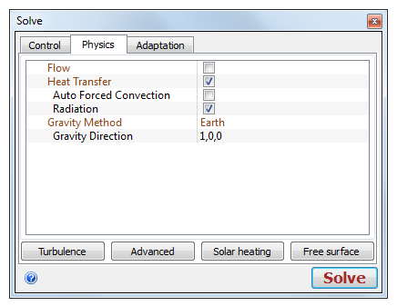

Click the Physics tab.
Flow = Off
Heat Transfer = On
Radiation = On

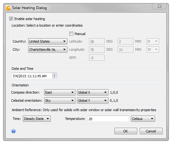

Click the Solar heating button.
Check Enable solar heating.
Pick a Country and City.
Set a Date and Time.
Click OK.
