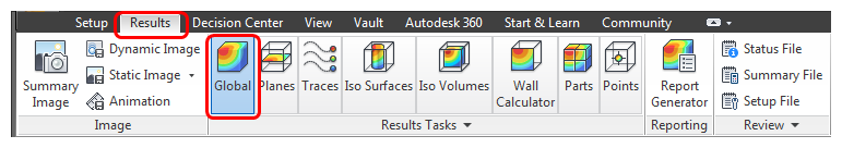

Click the Results tab.

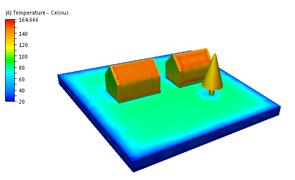

In this step we examine the temperature and solar heat flux to understand the effects of solar heating on the neighborhood. You should be able to see shadows cast by the houses and the tree as well.
Click Global from the Results tab:
Select Temperature from the Global Result menu on the Global context panel.
Hide the surrounding air (middle click) to show the houses.
