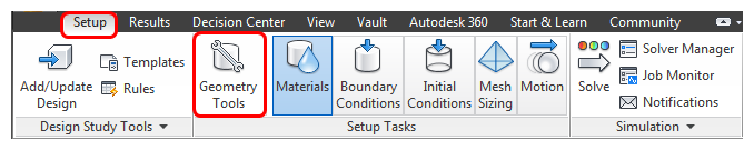

Click Geometry Tools from the Setup tab.
