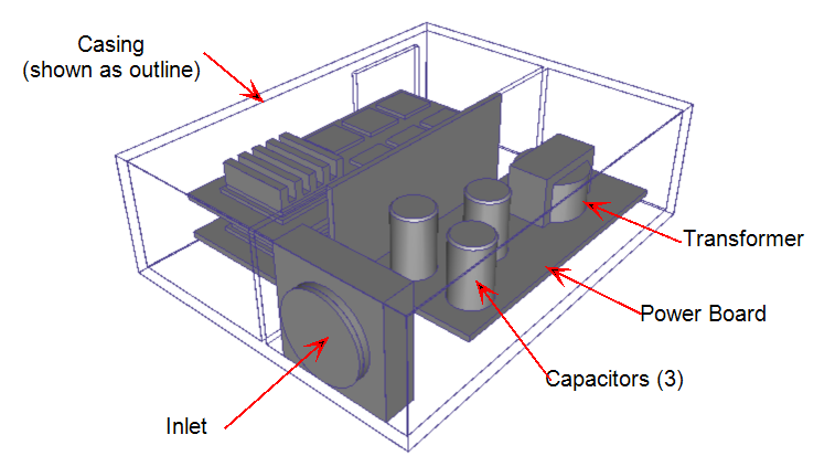

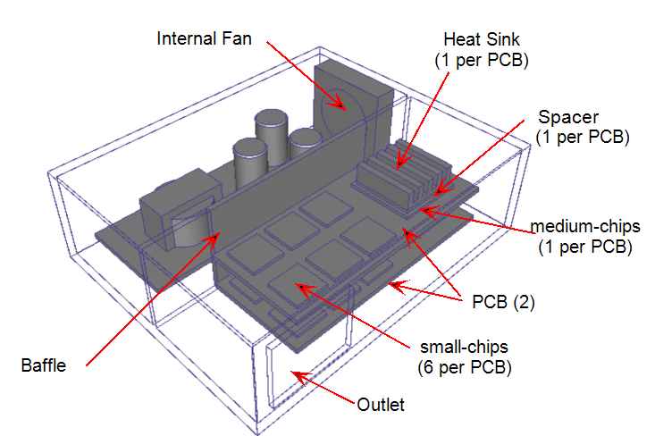

In this tutorial, we simulate the flow and heat transfer within an electronics enclosure. This system contains several components, and we model them with Autodesk® CFD material device models such as Compact Thermal Models, Internal Fans, and Distributed Resistance (porous media).
The solid geometry was created in a CAD system. We will create the air volume using the Void Fill geometry tool in Autodesk® CFD.
We will use groups to simplify the process of assigning settings to multiple parts.
Forced convection is the principal mode of heat transfer.
