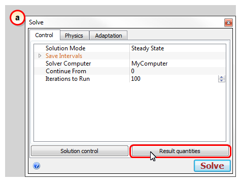

1. Click Solve from the Setup tab:

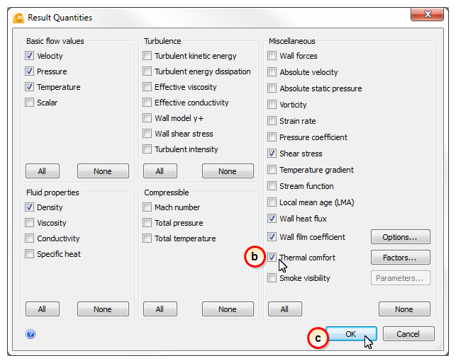

2. Select the Thermal Comfort result quantity:
- a. Click the Result quantities button.
- b. On the Results quantity dialog, check Thermal comfort.
- c. Click OK.

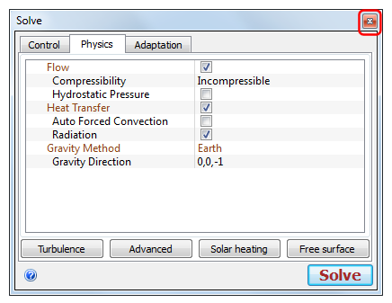

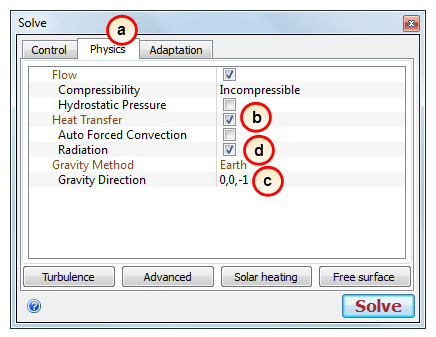

3. Define the Physical model:
- a. Click the Physics tab.
- b. Check Heat Transfer.
- c. Change the Gravity Direction to 0, 0, -1
- d. Check Radiation.
4. Close the Solve dialog by clicking the "X" in the top right corner.

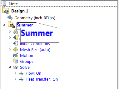

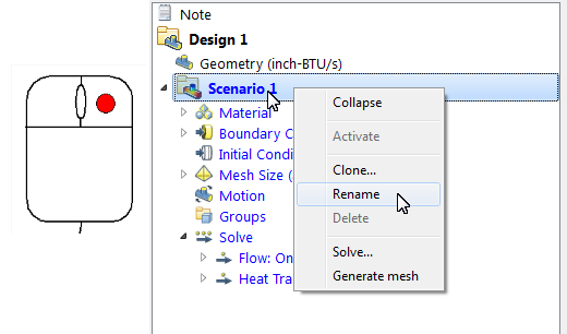

Note: Now that the Summer scenario is completely set up, it's a good time to rename the scenario to something a little more descriptive than "Scenario 1."
5. In the Design Study bar, right click on Scenario 1, and click Rename.
6. Type in "Summer" to replace "Scenario 1 ."
